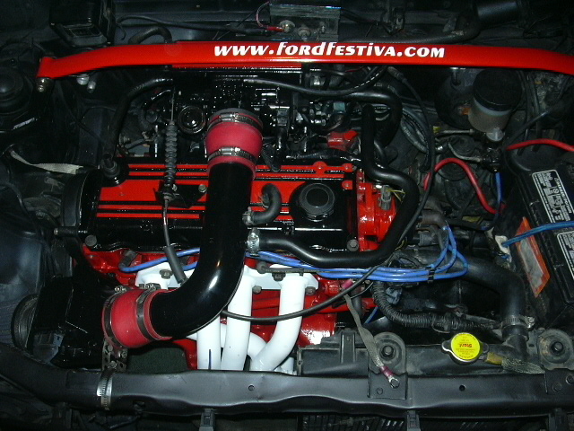

The original 1.3 L SOHC engine was replaced with a '89 Mazda 1.6 L SOHC NOS engine. A Genie header and custom intake were installed. 2.25" exhaust from the the flex joint back to the Arvin stainless performance muffler. Stock manual 5 speed transaxle with a Pacesetter short throw shifter. Psssttt.. If I drove it nice, I still got 40mpg.. ;-)
This engine is now D.O.A. After 2 years of thrashing and some serious miles.. 2 trips from Houston to Detroit and back and 1 trip from Houston to Phoenix and back, the thrust bearing went away at about 80 mph. It wasn't pretty. All the more reason to install my shiny B6T!!

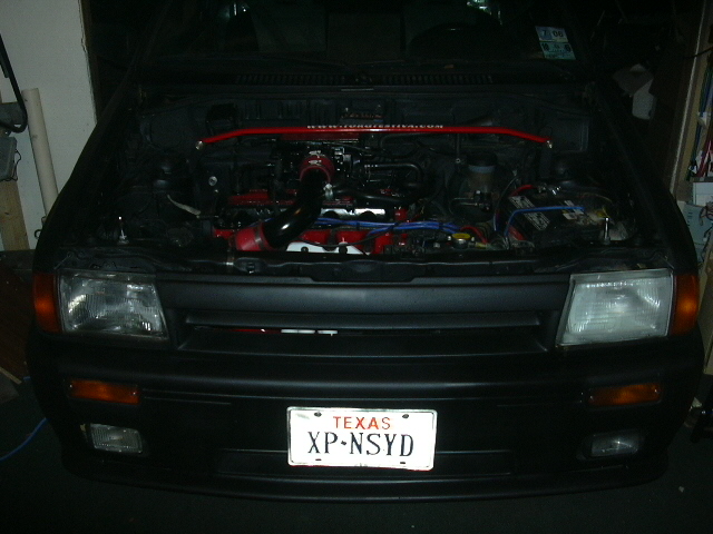

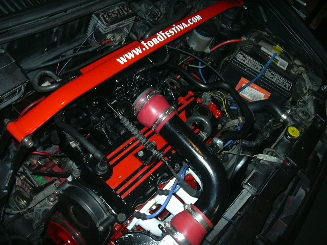

The B6T is a Mazda 1.6 DOHC Turbo engine found in the Mercury Capri XR-2 and the Mazda 323 GTX. I will also be swapping in a G25M-R Transaxle. I just need to fab up some mounts and install it all. I'd say at least high 14s. Even with all the weight of the system.
